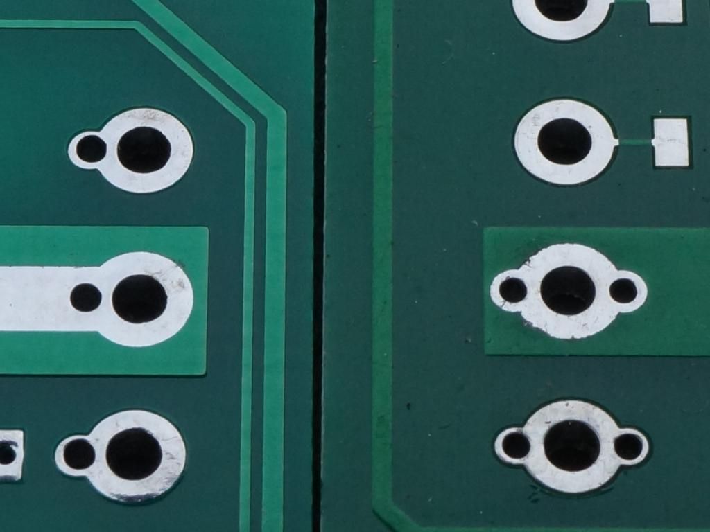

pcb 2oZ vs pcb 1oZ
http://i1232.photobucket.com/albums/...SC01762_cr.jpg
