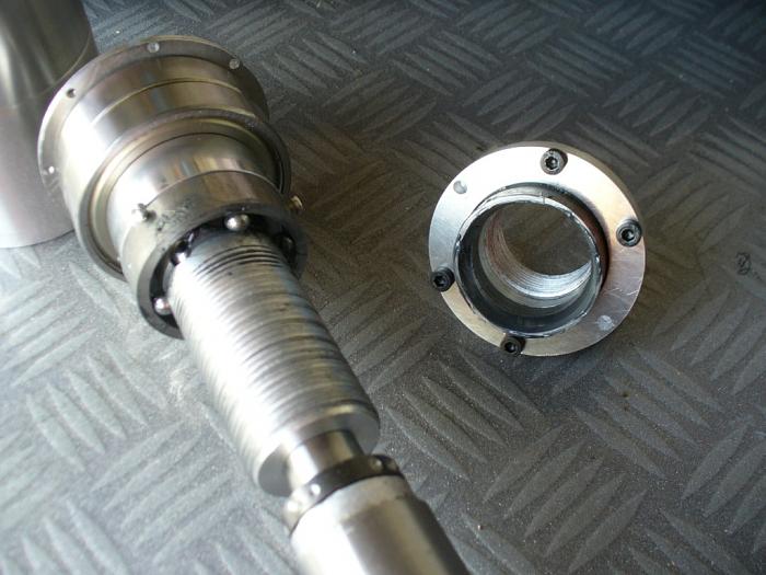

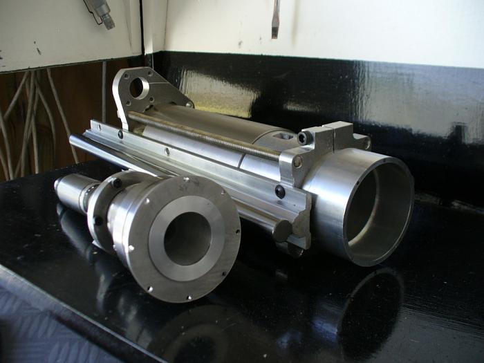

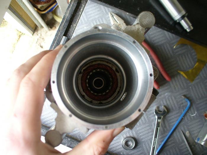

    Lỡ trích hình từ CNCzone.com rồi.. làm tới luôn.
    http://www.cnczone.com/forums/spindl...64470-cad.html

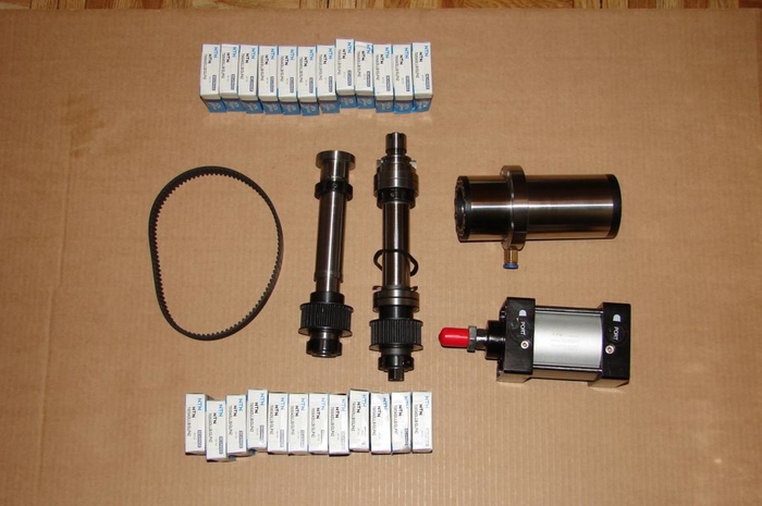

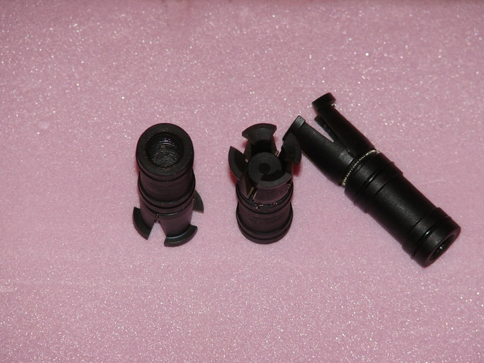

    As you can see from the following pictures, this product is no toy, it utilizes a petal-clamp system as found in larger ATC spindles and I have been assured by my electric spindle motor manufacturer that a real 10K RPM matching 220VAC 3-phase 3HP electric spindle motor with a 1024PPR quadrature encoder in a small footprint will be available within the next 6 months for about $750.00 USD (or less - unheard of in this industry) and made exclusively available at this price to the backers of this project so features like rigid taping is possible for those seeking the do-all VMC or milling machine.
    Cartridge
    Shafts
    Petal Clamps
    What to expect.
    The spindle cartridges and spindle shaft kits are supplied with NTN P42 25deg sealed angular contact bearings and are available with optional ceramic bearings at an additional cost.
    They support the following options/features:
    • 15K RPM (40K RPM with ceramic bearings).
    • Air or liquid cooling as required (easy to implement with the cartridge).
    • coolant through spindle.
    • air blowout.
    • small footprint.
    • BT15 or ISO15
    Reasoning.
    Like many avid hobby machinist, I want to increase productivity and increase the quality of the parts I produce and the use of an auto tool changer does this and the main goal of this project is to do it at an extremely affordable price that makes it impossible not to consider and I want it completed and available to everyone in a reasonable amount of time.
    The currently available quick-change spindle from IMS was found to be unsuitable to machine aluminum due to tool holder slippage and the other ISO10 tool holder spindle we tested was just as bad and both only came in ER11 collet size and we found this too limiting.
    As you can see, I have already completed the designs of the spindle cartridge and spindle shaft kit prototypes and would like to move to the production phase and mass production make it possible to do it at a reasonable price.
    Why ours is better.
    The use of ball style retention knob clamps (pull-stud gripper) were very disappointing due to the stress placed on the retention knobs by the balls due to minimal contact area and didn't have sufficient force to prevent toolholder slippage and the failure of the retention knobs due to this design far outweighed it's value so we quickly dismissed this as a quality/acceptable solution.
    We were equally disappointed in the finger (one-piece) clamps and how short their life expectancy was that they were quickly dismissed as well.
    Instead we decided to look at BT30 and BT40 tool change spindles that utilized a 15deg retention knob and decided that these designs were far more effective so we set out to find sources for these products but our findings left us outraged at the cost of the clamps that we just could not accept.
    IMSsas, a well known maker of these products offered us just the clamp at a cost of $525.00 for one and $375.00 in quantities of 50 pieces and they were the cheapest of the offers we received, finding this to be unacceptable we decided it's time for us to make them at a much more reasonable cost.
    The heart.
    The new petal clamp is made from 30CrNiMo8 (a Nickel Molybdenum Alloy), hardened and tempered for low wear and maximum strength, we have devised a machining process that allows us to make this part at an extremely reasonable cost at quantities of 25pcs (unheard of in the machining industry) so I can't understand why these companies charge so much for this product.
    In our initial clamp testing we had a few failures along the way, unfortunately I didn't take any pictures but we have figured out how to make the part so that it would sustain more than 3000N (the DIN/ISO specification for the 15 series tool holder maximum force is only 1700N) without failure.
    General components.
    The spindle shaft is hardened to HRC42 making it very strong and wear resistant and this is the most important part of a tool change capable spindle, if it doesn't have enough strength it couldn't maintain the allowable TIR under full load.
    The toolholders we are having produced for us because we just couldn't compete with the stringent tolerances and the cost of having these pieces ground to perfection made it uneconomical to produce ourselves and make them reasonably priced but did find a company who could produce them for us while maintaining the specifications.
    The basic tool change spindle components can be installed with hand tools by following simple directions/instructions and you can fabricate the other required components to finish it off with stuff you have laying around or purchase the parts you need.

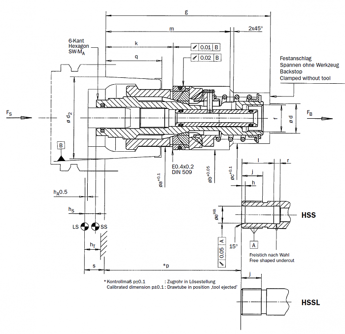

    Một trường phái mới.. lực kẹp lớn hơn, nhưng nhỏ gọn hơn.
    Thằng này dùng đuôi dao HSK.. một loại mới sau này, có nhiều ưu điểm hơn loại truyền thống.
    http://www.tacrockford.com/product/m...3.15306.000.1/
