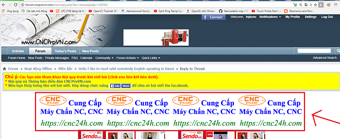

    Hi,
    Welcome to Vietnamese CNC forum. many suppliers in Vietnam they can help you to supply parts for DIY CNC plan. i can suggest one shop by this image, please try to contact with them.

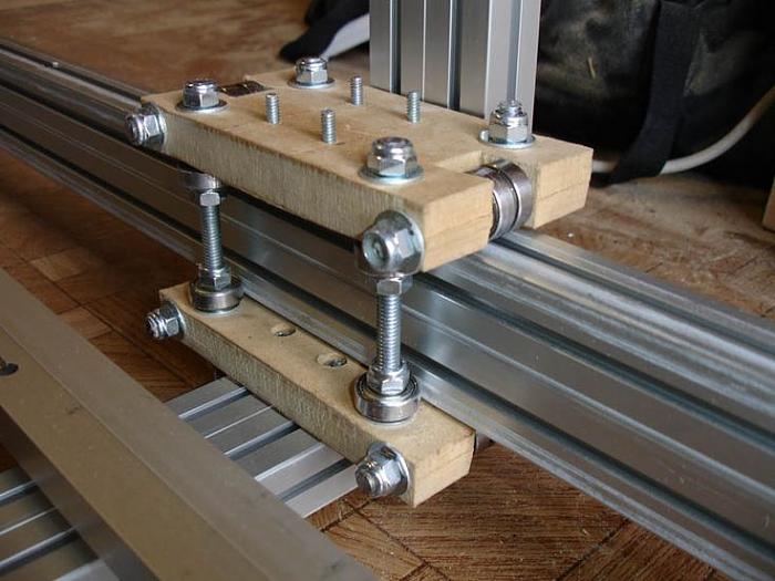

    Maybe about my plan. I want to cut plates for Surfboards from EPS foam. Because of the large scale I was reading my best option is a chain driven CNC for the X-Axis. The machine should have two options one router for wood and foam carving. this one will have y and z axis movement. and a hotwire with Z axis movement.
    For the guide rails I was thinking of Alu profile rais. But these are just my first ideas after reading a bit about CNC's.

    I think you should tell us how precise you would like so we can help you better. Also, if you want to have a router for wood, i think you should go with the round rail, they are cheaper than the square rail but still pretty precise for wood router.

    The alu frame will be weak and cost long time to align. I think solid beam solder is not an expensive option in Vn, refer to Mr. L... will get the idea that include square rail is more precise than round one, ofcourse need dust cover while working work wood to avoid getting stuck. Chain is not good while long trace compare with rack-gear, chain extends itself with time.

    In the video, i think they use extruded aluminum as frame and square linear rail. From your previous post, you are using the extruded aluminum also as rail. Using extruded aluminum as rail is cheap, but not too much reliable, they need alot of maintain and calibration. About Round and Square Rail, you can check this website out, i think they have pretty much every information you need about those two. http://www.machinedesign.com/archive/round-or-square
