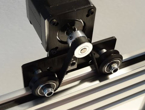

    Hello thx for all the nice replys. First about my Grammar i am not an English teacher I am an engineer from Germany. Engineers don't have time for Grammar ;-).
    Ok but the others I will contact mr.Luyen. Also garynguyen and IRF945. @ktshung Thx for the link. It looks very interesting. But I think it is to expensive for my first time CNC. The second hand Japanese parts is the best option for now i guess.
    Maybe about my plan. I want to cut plates for Surfboards from EPS foam. Because of the large scale I was reading my best option is a chain driven CNC for the X-Axis. The machine should have two options one router for wood and foam carving. this one will have y and z axis movement. and a hotwire with Z axis movement.
    For the guide rails I was thinking of Alu profile rais. But these are just my first ideas after reading a bit about CNC's.
    this part looks good for to me.Đính kèm 60126
    I like your phrase "Engineers don't have time for Grammar".
    By the way, in Vietnam, aluminum profiles are expensive, unreliable (they are not really straight and they are really soft, easy to bend). Wood is also not a good idea for long term. Meanwhile ready made linear rails are dirty cheap. Just ask Mr. Luyến, he can help you, don't waste time reinventing the wheel.

    @ flexbex
    Bạn có thể xem qua link này: http://forum.cncprovn.com/threads/35...re-foam-Cutter
    Diễn đàn không có nhiều chia sẻ về foam cutter, bạn có thể tham khảo hình ảnh và website bán linh kiện sau:
    http://diycnclaser.com/san-pham/nhom-v-slot-20x80
