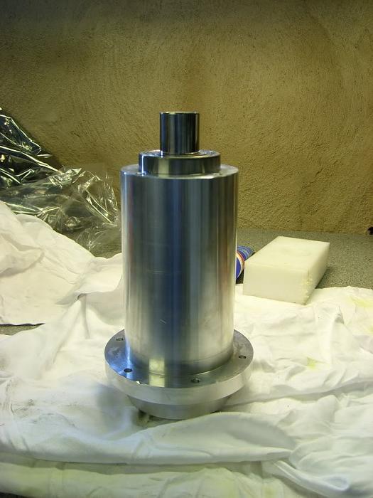

    I started by making the housing for the spindle. At first I intended to make it out of steel or even stainless but changed my mind and made it out of aluminum. If it turns out to be bad choise I'll either make new one or have one made (I don't want to do it again, see below...) Anyway, here's a couple of photos of the process:
    160mm dia aluminum round bar ready for machining:
    Cục nhôm phi 160x250 (đoán thế ), ước lượng khoảng 1500K
    I turned down the outer diameter of the lower part and the flange and then started to drill out the ID:
    When the bulk of the material was drilled out I machined the seat for the lower bearings, here I'm using a three-point micrometer to measure the diameter - 71.985mm for a 72mm bearing:

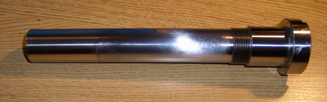

    Next task to tackle was making the actual spindleshaft. It's made of steel (2511) and the lower end will be hardened and ground. Here's a photo of how it looked after the first operation:
    The threads are M32 X 1,5 and will be used to press the inner rings of the two lower bearing together. The outer rings will be pressed together by the lower flange. What's left to do here is an internal thread at the top that will be used to hold the drawbar assembly in place as well as preloading the spring washers. And to machine it to length and turn the taper for the toolholder.
    Turning the taper wasn't as easy as I thought it would be, (never done it before) it took two testpieces and a lot of fine adjusting the cross-slide to get it good enough.

    And here's the finished spindleshaft. You can see the "collet" just above the threaded section.
    The spindle shaft and the drawbar assembly have now been sent out for hardening and grinding. Hopefully I'll have it back in a week or two.
    Cái khó nhất theo CKD là vụ cái trục này. Bên ngoài thì không ngại vì CKD làm hoài, góc côn cũng không quá khó, nhưng lỗ & bật bên trong thì chưa tìm được giải pháp toàn vẹn.
    Lỗ bên trong đáng ngại vì dao yếu thì càng vào sâu càng cong nên lỗ sẽ nhỏ dần. Phải làm một con dao có đường kính gần bằng lỗ mới được. Lúc đó thì tay nghề cần phải xịn hơn vì không thấy đường mà làm. Tiện CNC thì không có gì để nói nữa...
    Hmm, mà sao mấy chú Tây làm được mà anh em ta làm ko được ta?
    Làm thì được nhưng phải có máy tiện ngon một tí. Vì yêu cầu độ đồng tâm khá cao mà.
    nếu trục ko quá dài, tầm 400 đổ lại thì khoan lỗ trước, trui mài xong đi cắt dây cũng dc
    nhưng nếu thế phải tính toán lại cái bậc lò xo kéo
    p/s khoan lỗ sau chỉ có các nhà máy Z ngoài bắc mới xử nổi thôi, đám đó chuyên khoan nòng súng mà

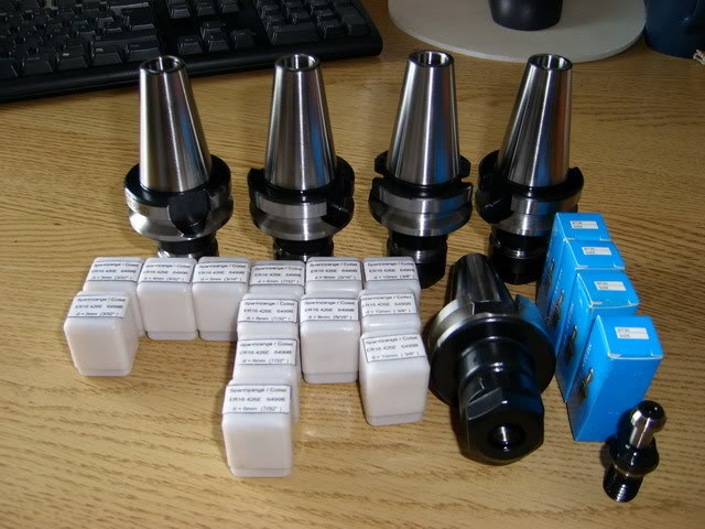

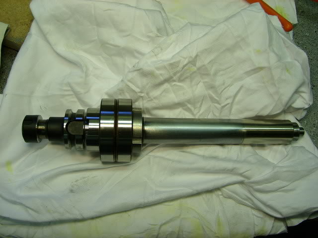

    Finally things starts to come together. I got the grinded shaft back the other day - looks absolutely beautiful:

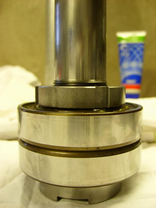

    I cleaned the two lower bearings and packed them with grease. The recomended amount for 72XX series bearings is 1.3cm³ but I didn't have any good way to measure that so I filled them, rotated, whiped off excess, rotated again and so on.
    I then put the shaft in the freezer and the bearings in the oven on low heat, 80-100C and left them there for a while:
    After that they went together without too much effort. I used a piece of aluminum pipe and a plastic hammer to push them om the shaft:

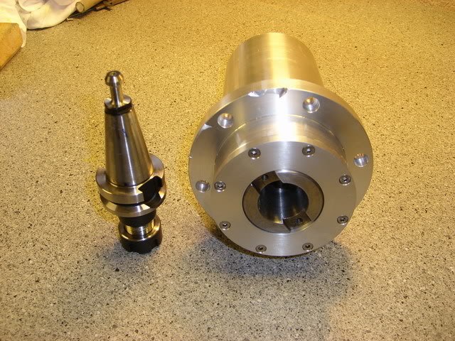

    Then I found out that I didn't have any LOCTITE to secure the KM-nut to the shaft so the couldn't mount it in the housing. But I pressed the drawbar tube into the spindleshaft and temporarily fit the gripper to the drawbar for a first test - seems like it actually might work!!

    Khi mình dùng pp nóng lạnh này để gắn cốt với bạc đạn thì lỡ làm sai thì làm sao gỡ ta?
    Lần sửa cuối bởi Gamo, ngày 22-02-2015 lúc 07:15:52 PM.

    After having the shaft in the freezer and the housing in the oven for a while they slipped together quite smoothly. The upper bearing, on the other hand took some convincing to get into place. In this photo it's about half way down to it's final destination but after a while I got it all the way down.
    At first the spindle turned very easily but after mounting the lower flange, introducing the preload, it's a bit harder to turn but it's still really smooth. I left the seal out for now.
    Then I assembled the drawbar and mounted the belleville washers for as little force as possible and did a crude test. I had to push quite hard to get the drawbar down enough for the pullstud to "click" in - it actually seems as if this is going to work.
    gõ ra thôi chứ đâu có sao, xui xui hỏng cái bạc đạn thôi
    thực ra nóng lạnh hoặc nóng không thôi cũng đủ rồi, vì cốt mài chính xác = lỗ trong, nên khi lắp ghép hơi khó
    chứ bọn chuyên repair nó chỉ cần khò nóng là lắp vào nhẹ nhàng àh
