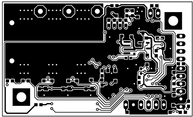

    Layout
    Schematic capture and PCB layout were done in EAGLE. The final layout is surprisingly concise.
    Layout priority was, naturally, given to the power stage. Input power is distributed to the 3 half-bridges by large unbroken copper fills on the back side of the board. Bridging the two rails is a whole slew of ceramic decoupling capacitors. The MOSFETs are all on the top side, with plenty of vias connecting to the power fills (for both electrical and thermal reasons). Outputs from each of the half-bridges are routed through the current-sense resistors (for 2 of the phases, and a dummy 0-ohm resistor for the 3rd) directly to off-board wires going to the motor (off-board, in-line connectors would be used in the final robot – on-board connectors of suitable current handling capacity would have substantially increased the PCB size).
    The MOSFET driver chips are placed near their respective half-bridges. The high-current gate/source drive paths between the driver chips and the MOSFETs are routed adjacent to each other to improve drive waveforms.
    Analog current-sense paths were given similar attention. The differential traces from the sense resistors to the amplifier chips were routed (as much as is possible with a 2-layer PCB) to avoid non-common-mode interference (the differential amplifiers would, of course, remove most common-mode noise).
    The SMPS needed to have its current-loops minimized, as well – which wasn’t a problem, given how small it was.
    The rest of the board had relatively simple routing requirements. Aside from the CPU’s crystal oscillator and per-chip decoupling, the remaining chips and traces could go wherever they fit.
