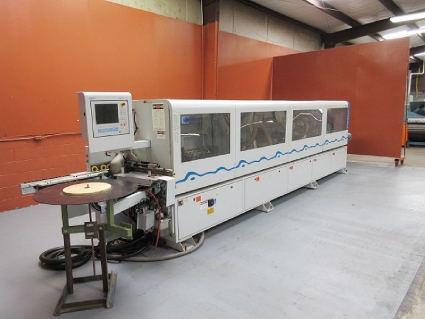

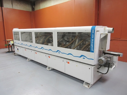

Máy dán cạnh Brandt KDF 980, Edgebander (2007)
0.4 – 20 mm edgebanding thickness capacity
12 – 65 mm edgebanding height
Minimum panel length: 160 mm
Minimum panel width: 65 mm
Pre-milling unit with (2) 3 HP 12,000 RPM motors
Quick melt gluing system with large granulate hopper
Pre-melting unit between hopper and glue roller
(1) Driven pressure roll, (4) Idle rollers
End trimming station with (2) 1 HP 12,000 RPM motors (program controlled pneumatic indexing)
Flush trimming unit with (2) 2 HP 12,000 RPM motors with pneumatic horizontal positioning

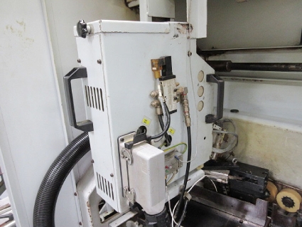

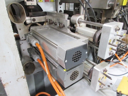

Fine trimming unit with (2) 3/4 HP 12,000 RPM motors with servo motor controlled positioning and auto tilt feature

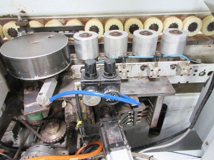

4-Motor corner rounding with (4) 0.5 HP 12,000 RPM motors and servo motor positioning of units to edge thickness
Scraping unit for chamfer or round shaping of roughly trimmed thick PVC edgings with program controlled pneumatic indexing
Top and bottom oscillating jump buffing unit with (2) 1/3 HP 2,800 RPM motors
Variable speed feed 36-65 FPM with 3 HP motor

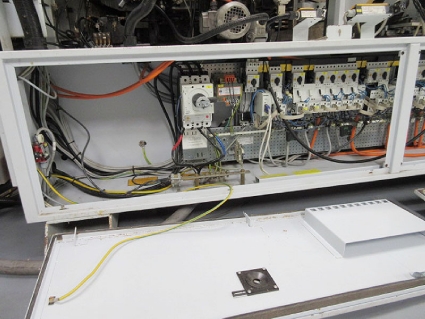

“Power Control PC 20” controller
Machine will require transformer (not included with machine)
